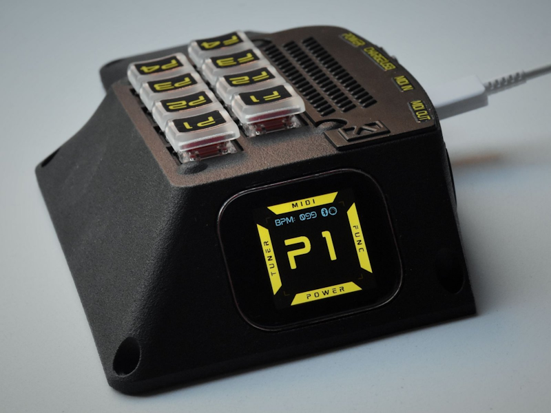

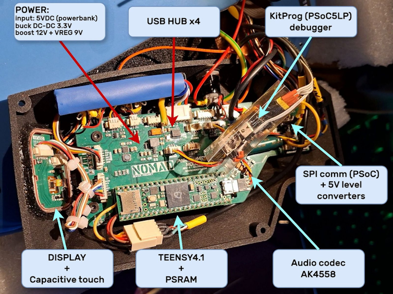

Around back, a Teensy 4.1-powered DSP and power module is housed in a 3d-printed enclosure. The Teensy provides MIDI and power management, plus extensive digital effects, including a drone synth, looper, and sample player. Eight keyboard switches, a button gamepad joystick, and a repurposed smartwatch display provide control.

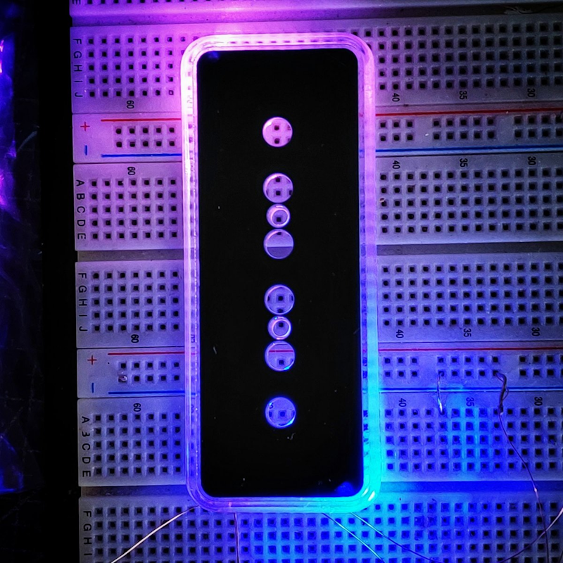

Among the many fascinating details of this project are the LED-illuminated P90 pickups, which indicate their status via colour, and required their own pickup winder to be developed, in addition to transparent 3d-printed resin covers.
