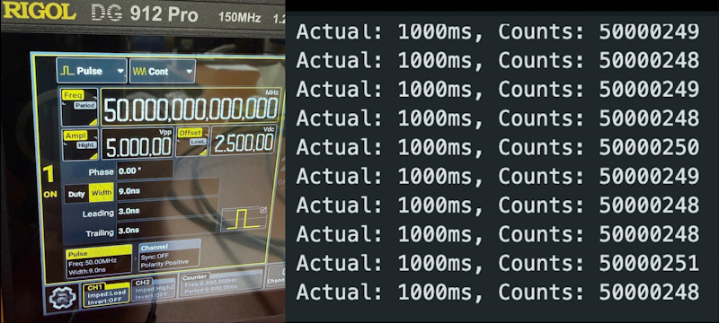

Using the FreqCount function, Yongsup iteratively reduced the pulse width until behavior became erratic. The Teensy 4.1’s 600MHz clock gives a theoretical resolution of 1.67ns, and was observed counting as little as 9ns pulse widths at 50MHz. The Rigol DG912 Pro waveform generator being used to test it has a rise/fall of 3ns, so reducing further would have been hard to measure anyway.
