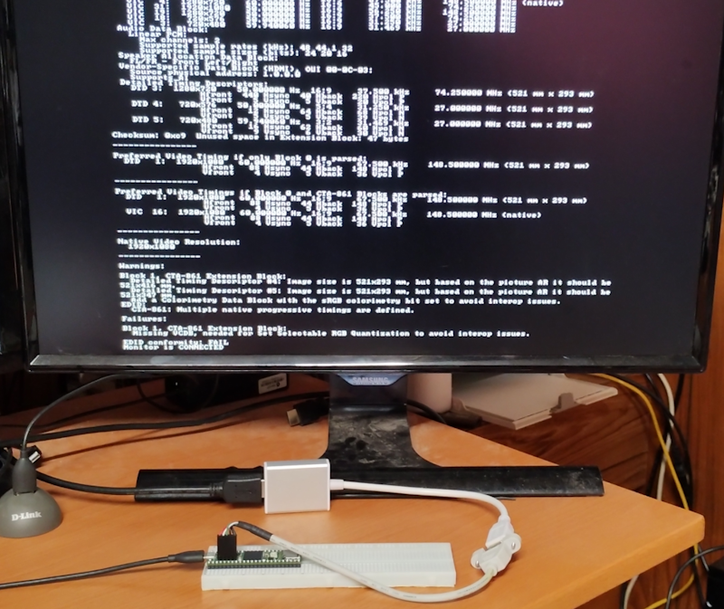

Typically available for less than $20, these devices can add up to 800×600 pixel SVGA-class video output (limited by USB 2.0 bandwidth) via the Teensy 4.1 USB Host Cable (or Teensy 4.0 USB Host pads). The adapters are available in VGA or HDMI form, although the implementation uses DVI-compatible mode for HDMI, meaning no audio. They can also be used to generate radio signals.
