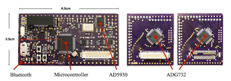

A custom PCB featuring a Kinetis K20 MCU running Teensy 3.2 firmware hosts the voltage-controlled current source (VCCS), direct digital synthesizer (DDS), an ADC preamp, and a Bluetooth module for wireless data transmission. Read more on Chris or Yang‘s web sites, or check out the video below.
