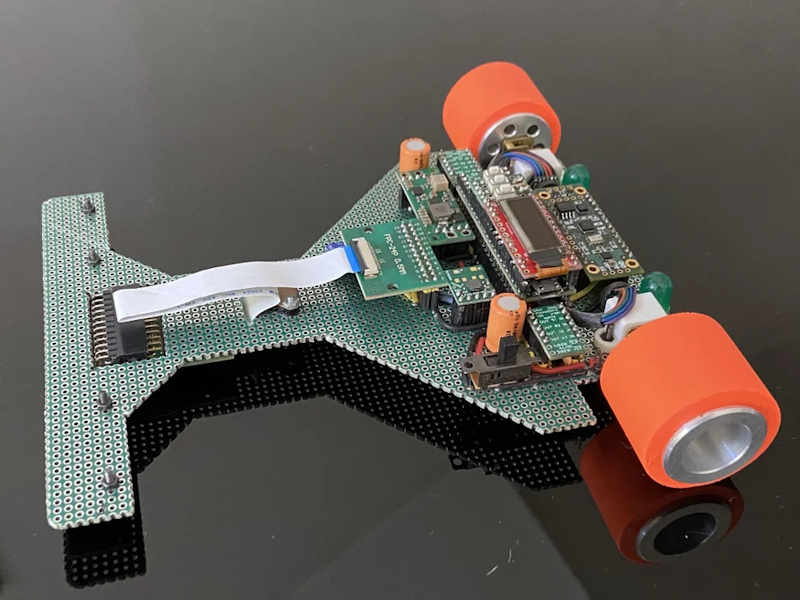

Line-Following Robots are a fun way to get started with robotics, as well as to compete with others to see how your skills stack up. Midhun has created a unique, well-documented LFR.
An array of IR LED/phototransistor pairs in the form of Pololu’s QTRX line sensors give the bot eyes, while perfboard is used not only to connect its various breakout boards, but also to form its chassis. Dual 6V 1580 RPM high-power 15:1 gear motors power the unit, with encoders for position and distance estimation and the 10DOF motion sensors from our own Prop Shield providing heading and position. A  SparkFun TeensyView displays telemetry, calibration and other functions. An overview of the LFR can be seen in the video below, with complete, detailed build instructions on Instructables.

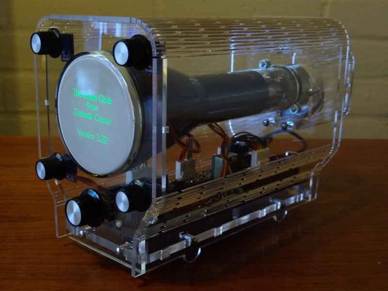

Perhaps the first ever “video game,” William Higinbotham’s 1958 Tennis for Two used an oscilloscope was used to render the match.  More recently, Nixiebunny brought things full circle with their Teensy 3.6-powered Scope Clock.
The clock uses the Teensy’s DACs to render the display, which can take the form of an analogue or digital clock face, but can also be used, along with the device’s integrated knobs, to play Tetris, or that other famous ball-bouncing simulator: Pong.
An integrated USB port allows for the addition of a gamepad or GPS receiver. While the code is not currently available, Nixiebunny has plans to make it open-source once the device is on sale.
Unlike William Higinbotham’s 1958 Tennis for Two which simulated the physics of the titular ball on the Donner Model 30 analogue computer, requiring considerable equipment for a public showing in 1959, Nixiebunny’s compact all-in-one build uses modern electronics paired with a Cathode Ray Tube.
