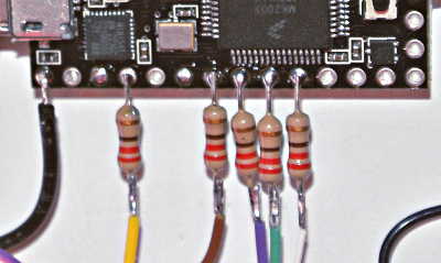

Signal Quality
While testing OctoWS2811, the 5 volt WS2811 chips were able to work with Teensy 3.0's 3.3 volt output signals. However, a series resistor located close to the Teensy 3.0 pin is often necessary to reduce ringing and cross-coupled signals.
Signal after 12 inches of wire
With 220 ohm resistor added
The series resistors help match Teensy's outputs to the characteristic impedance of your wiring. The best value to use depends on the type of wire and its spacing to nearby ground wires. Values in the range of 47 to 220 ohms are probably best.
Update: This OctoWS2811 Adaptor is now available, with the 74HCT245 buffer chip, 100 ohm resistors, and RJ-45 jacks for CAT6 cable, which exactly matches 100 ohm resistors. This adaptor is highly recommended for any large LED project. Please also follow its wiring recommendations, where the LED power supplies are located close to the LED strips using short wires for the power, and signal grounds from Teensy meet the power ground at or near the LED strip data inputs.
Place resistors close to the Teensy pins.
The WS2811 input high specification of "0.7*VDD". To truly meet this requirement, a buffer chip should be used to convert the 3.3 volt signal to 5 volts. A 74HCT245 is recommended.

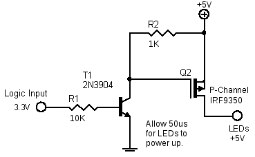

WS2811 Idle Power
When the LED is off, the WS2811 chip consumes approximately 0.9 mA of current. For battery powered LEDs, this current can easily drain the battery. A P-channel MOSFET transistor or similar switch may be needed to disconnect power from the LEDs, if the battery remains connected when the LEDs are not in use.
This circuit was recommended by David Beaudry to manage the power. David also tested Vishay SUP75P03-07-E3 and SI4465ADY-T1-E3 transistors, which are able to power more LEDs.
