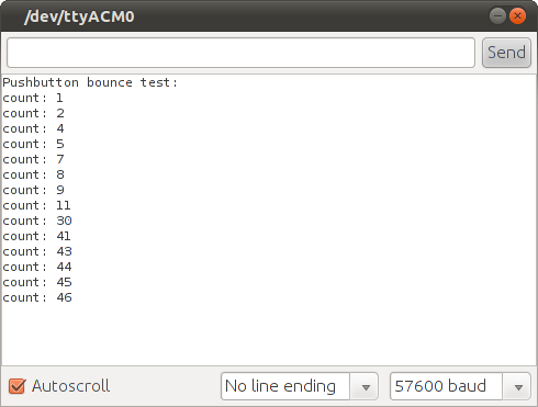

Example With Contact Bouncing
This example does NOT use the Bounce library. You can use this code to test if your hardware has mechanical bounce.
It reads a pin as rapidly as possible. Each time the pin transitions from high to low, a count variable in incremented. The count is only printed 0.1 second after activity stops, to avoid any delay caused by Serial.print() from interfering with reading the pin quickly.

As you can see, sometimes the count increases by more than 1. Some of the count increases in this example occured while releasing the button. The Bounce library solves these problems.
Without Bounce Library: Some Button Presses Cause Several Counts

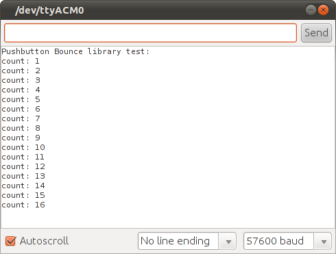

Example Using Bounce Library
This example uses the Bounce library to read the pin, but otherwise has the same structure as the example above.

Because the Bounce library handles the mechanical bounce properly, the count increases exactly once for each button press. False counts during button release are also avoided.
With Bounce Library, Each Button Press Increments Count Once

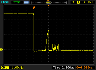

Actual Bounce Waveforms

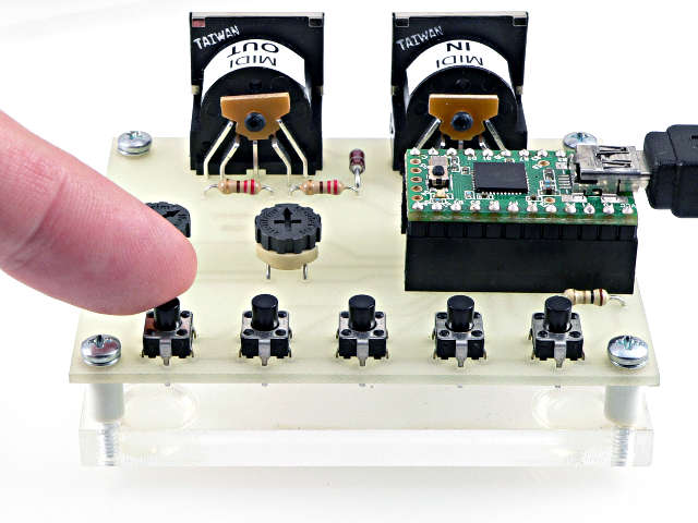

The board shown above uses 5 quality pushbuttons, which have very little mechanical chatter. In this waveform, the bouncing action ends within 10 µs.
Pushbutton on board shown above
