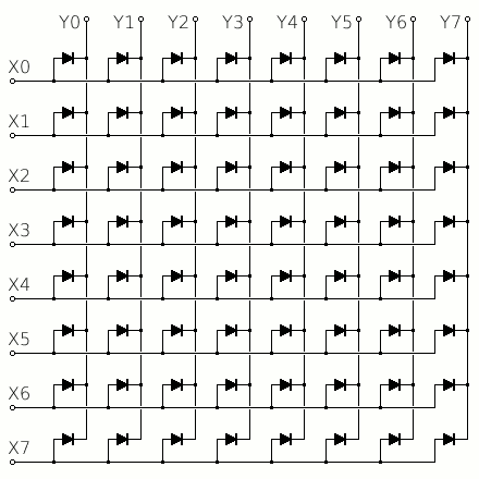

The 64 LEDs are connected in a simple matrix arrangement.
If you have a pre-wired display block, like the 3 used in the photo above, make sure you orient them so the anodes are the X axis signals and the cathodes are the Y axis signals. Desoldering them to rotate 90 degrees is not fun!
