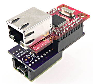

The simplest way to use Ethernet with Teensy 2.0 is the WIZ812 Adaptor Kit and WIZ812 Ethernet Module (made by Wiznet and sold by Saelig and other companies). For Teensy LC, 3.0 - 3.6, this WIZ820+SD Adaptor and the WIZ820io Module are recommended,
W5x00 must have chip select signal connected to Teensy pin 10.

WIZ812MJ Module Connections
The WIZ812 Adaptor Kit is the easiest way to use the WIZ812 Ethernet module. But it can also be connected with only 6 wires.
WIZ812MJ Ethernet Module
Only 4 signals (MISO, MOSI, SCLK, SS), plus 3.3 volt power and a reset are required to make the WIZ812MJ work with Teensy or Teensy++. The WIZ812MJ has many pins, but nearly all connect to ground or 3.3 volts, or aren't used at all.
