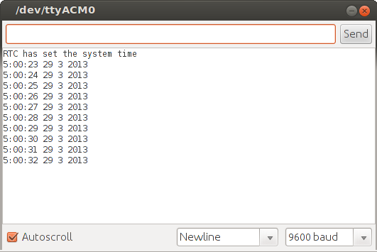

TimeTeensy3 Example Program
TimeTeensy3 demonstrates synchronizing Time to the Real Time Clock in Teensy 3.0, 3.1, 3.2, 3.5 & 3.6.
To use the Teensy 3.0, 3.1 & 3.2 RTC, you must add a 32.768 kHz, 12.5 pF crystal to the bottom side of the board. The crystal shown is Citizen part CFS-206, Digikey part 300-8303-ND, 300-8762-ND, 300-8763-ND, or 300-1002-ND. Teensy 3.5 & 3.6 have this 32.768 kHz crystal built in.
The Teensy 3.x RTC will work without a battery, but to retain the time and date while power is off, of course you must also add a 3V battery.
You can open this example from File > Examples > Time > TimeTeensy3.
The time can be set using the Processing program from TimeSerial above.
