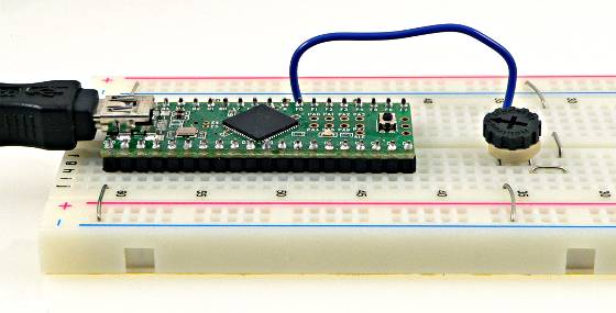

Hardware Requirements
All Teensy boards have EEPROM memory build inside the chip. No extra hardware is required. The demo program reads an analog voltage and stores it into EEPROM, so a trim pot was connected to analog input A0.

The examples can be opened from the File -> Examples -> EEPROM menu.The Write example was run while slowly turning the trim pot counter clockwise, where it wrote decreasing numbers into the EEPROM. Then the Read example was run, producing this output:
