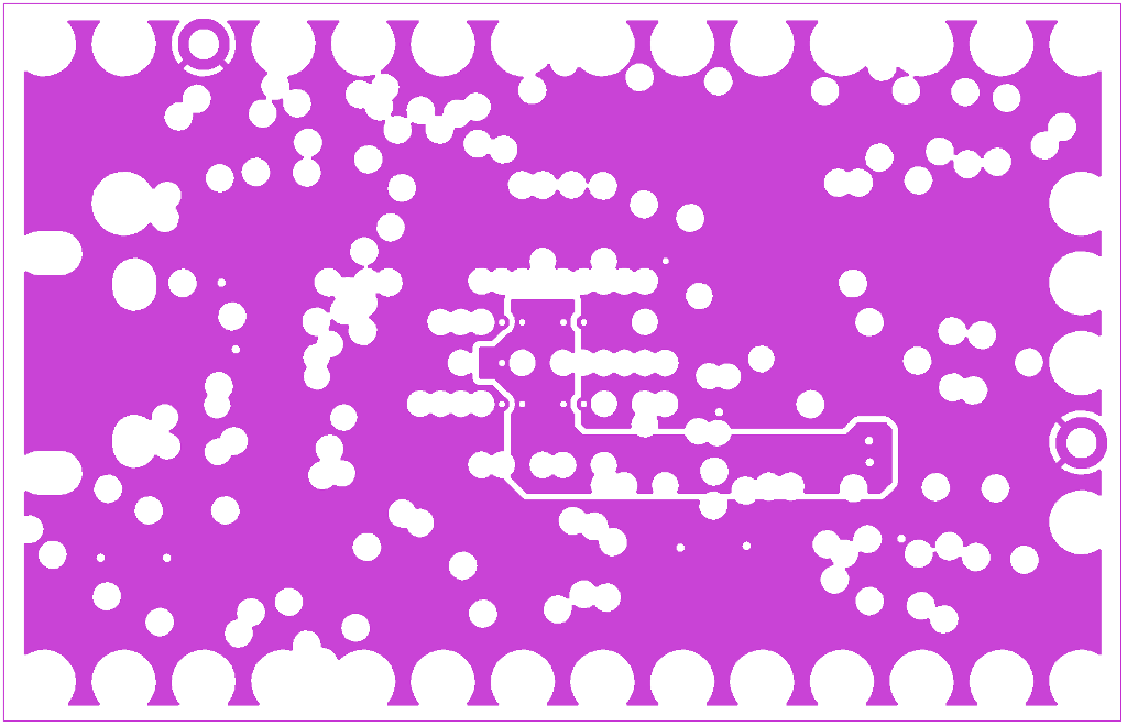

PCB Design and BGA Routing
Ball Grid Array (BGA) routing can feel daunting. Don't be intimidated. For inspiration, here is the PCB layout used for an early 4 layer Teensy 4.0 prototype.
With the smaller 10x10mm BGA chip, where the pins are at 0.65mm pitch, signals and ground/power planes can not route between adjacent vias on other layers (unless using an expensive premium PCB process).
One BGA routing strategy is keep some rows free of vias. This approach allows only about half of all the pins to be used, which is plenty for the Teensy 4.0 design. The no-via rows allow power & ground to connect on the inner layers, and provide space for decoupling capacitors or signal routing on the bottom layer.
With the larger 12x12mm BGA chip, where the pins are at 0.8mm pitch, adjacent vias do allow a signal to route between them on other layers. For a design where more than 60% of the BGA pins must be routed, the larger 0.8mm pitch BGA chip allows use a standard PCB process.
