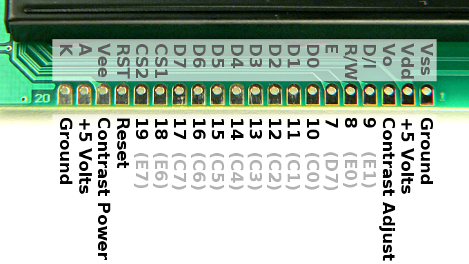

Connecting the LCD to Teensy or Teensy++
Standard Connections for Teensy++ 1.0 or 2.0:
Standard Connections for Teensy 2.0:
Alternate connections for Teensy 2.0: (you must edit the code to enable this connection)
The display requires a contrast adjustment potentiometer. A value of 5K or 10K works well. The center terminal must connect to the "Contrast Adjust" pin (Vo). The two side terminals must connect to the "Contrast Power" pin (Vee) and Ground. It does not matter which sides of the potentiometer you connect these 2 signals, as the reverse connection will simply make the clockwise rotation adjust in the opposite direction.
The reset pin should be connected to +5 volts. It is not necessary to drive the reset pin low before using the LCD.
Alternately, the reset pin may be connected to any unused pin on your Teensy, if you want a hardware connection that resets the LCD to its default state. Before initializing the LCD, output a low to reset the LCD, then high to allow it to operate. For example:
void setup() { pinMode(3, OUTPUT); digitalWrite(3, LOW); // reset the LCD delay(10); digitalWrite(3, HIGH); // allow it to run GLCD.Init(NON_INVERTED); GLCD.ClearScreen(); }
