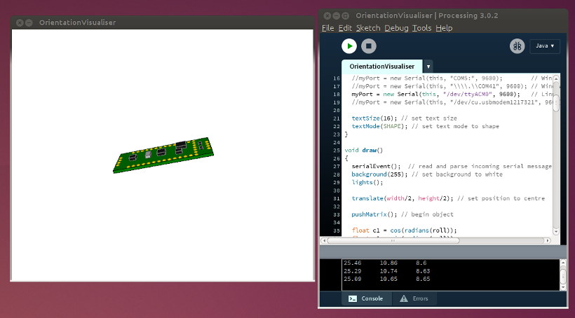

When either of these is running, the Arduino Serial Monitor will show you computed Heading, Pitch and Roll. As you turn the board in each direction (imagine it's an airplane), you should see each angle change.
To see the orientation data in graphical form, use Processing to run the Orientation Visualizer. You many need to edit this code with your serial port name. Of course, close the Arduino Serial Monitor window, so the Processing sketch can access the data.

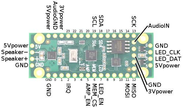

Technical Details
| Signal | Pin # | Used By: | Description |
| SDA | 18 | sensors | I2C Data for motion sensors |
| SCL | 19 | sensors | I2C Clock for motion sensors |
| IRQ | 2 | sensors | Interrupt from motion sensors |
| MOSI | 11 | memory,led | SPI Data |
| MISO | 12 | memory | SPI Data |
| SCK | 13 | memory,led | SPI Clock |
| MEM_CS | 6 | memory | Low to access memory |
| LED_EN | 7 | led | High to send LED data |
| LED_DAT | - | led | 5v buffered LED Data output |
| LED_CLK | - | led | 5v buffered LED Clock output |
| AMP_EN | 5 | amp | High to enable amplifier |
| AudioIN | DAC | amp | Audio signal |
| AudioGND | AGND | amp | Audio ground |
| Speaker+ | - | amp | Connect a 4Ω or 8Ω speaker Twisted pair wire is recommended |
| Speaker- | - | amp | |
| 5Vpower | VIN | amp,led | |
| 3Vpower | 3.3V | sensors,memory | |
| GND | GND | (all) |
