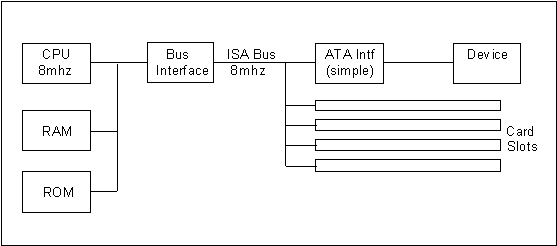

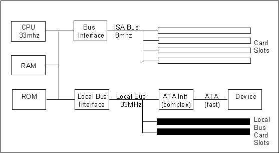

                When the IBM PC/ATÔ was introduced in 1983, the 8 MHz 80286 processor quickly became the dominant platform. The AT bus (now called the ISA bus) became standardized around an 8 MHz processor speed. When the first ATA disk drive was introduced a few years later, it was designed as a simple extension of the bus – hence the name "AT Attachment" interface (see figure C.1). The idea was to remove the disk drive controller electronics from the PC and place them on the drive instead. What remained on the PC was a pair of bidirectional data buffers and an address decoder. This simple interface was most often implemented with a pair of 74LS245 buffers and a programmable logic device such as a PAL. These TTL devices had rise and fall times in the 5 to 6 ns range. Although this was fast enough to cause some ringing on the ATA bus, it was not so severe as to prevent millions of successful system implementations.
                Figure C.1 – Original IBM PC/AT architecture
                The architecture of modern PCs has changed somewhat from the original PC/ATÔ . As the processor speed increased it became necessary to separate the processor bus from the ISA bus (see figure C.2). To maintain compatibility the ISA bus continues to run at an 8 MHz rate. Processors, and their associated busses, have increased from 8 MHz to 12, 16, 25, and now 33 Mhz.
                Note C.1 - Processors that run faster than 33 MHz, such as the 486DX2-66, still tend to keep the external processor bus at 33 MHz.
                Disk drives have also increased in speed. The increase in rotational speed and linear bit density has increased the rate at which data comes off the heads, and the presence of cache on the drive makes data available at the access rates of RAM. This has created a data bottleneck at the ISA bus. The drive is faster, the processor is faster, but the data can’t be moved from one to the other any faster.
                Figure C.2 – Modern PC architecture
                This bottleneck inspired the invention of new, faster interfaces to the processor. Local busses are designed to run at the speed of the processor bus. Two local bus standards have emerged, the VESA Local Bus (VLB) and the Peripheral Component Interconnect bus (PCI). These local busses have the potential for faster data transfer from the disk drive to the processor.
                To allow ATA disk drives to transfer data faster, the ATA standard had to be updated to allow faster transfer rates. These enhanced modes are still not as fast as a processor bus. To synchronize the data flow between 32-bit 33 MHz processor busses and slower 16-bit disk drives, a VLSI chip is required. Most of these bridge chips were implemented with fast CMOS processes to achieve the required bus speeds. As a result the edge rates on the ATA bus were often 1 to 2 ns, and sometimes less. These fast edges have aggravated the ringing on the bus to the point that system/drive combinations fail to work.
                In summary, the reason for signal integrity problems appearing now, when they were absent before, is the advent of faster transfer rates on the ATA bus coupled with a change of IC process at the interface. The problems are not insurmountable, and in time it is likely that the ATA bus will be known as a robust, fast, and inexpensive interface.

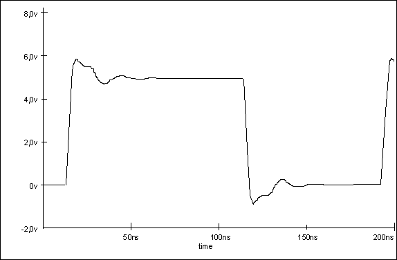

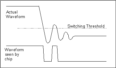

                2. Many users have experienced problems with early implementations of PIO Mode 3 devices and hosts. Most failures in the systems observed can be attributed to signal integrity problems on the control lines that go from the host to the device. The problem appears most frequently as ringing on the DIOR- (read command) and DIOW- (write command) lines.
                  During a read cycle when DIOR- is asserted, it is possible for the ringing to create a short duration deassertion pulse (see figure C.3). This pulse occurs early in the read cycle. Inside the ATA interface portion of the datapath controller chip is a FIFO buffer that contains the data to be read. The extra pulse on the DIOR- line advances the FIFO pointer by one. This results in losing one word of data. The host system read operation therefore receives one word too few, and the remaining bytes are shifted. A typical data sequence might look like . . .W7, W8, W9, W11, W12 . . . Notice that word 10 is missing from the returned data. This also means that the host tries to read one more word from the device than the device has remaining. Depending on the implementation of the BIOS, this locks-up the system or simply returns a byte of garbage at the end of the sector.
                  Pulse slivers due to ringing on the DIOW- line cause a similar problem during writes. The pulse sliver advances the FIFO pointer by one unexpectedly, writing an extra word of garbage into the FIFO. Subsequent data bytes are shifted by one word. A typical stored data sequence on the device might look like . . . W7, W8, W9, XX, W10, W11 . . . In this example an extra word was inserted during the write cycle for word 10. From the device's point of view, the host is trying to write 514 bytes rather than the expected 512 bytes. The device throws away the final word and should flag an error. A properly written BIOS detects this error and indicates a problem to the user.

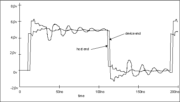

                  Figure C.3 – Typical ringing on ATA bus and its effect
                  These are only two examples of a systemic problem. Ringing on any control signal, and possibly on data lines, can cause system failures or data loss. To address this problem it is necessary to examine the circuit structure of the ATA bus.

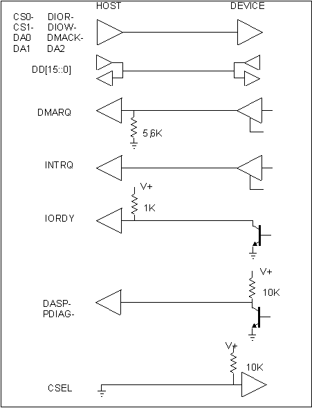

                  Figure C.4 shows the seven basic driver/receiver structures that appear in ATA bus interfaces. The host circuitry appears on the left side of the diagram and the device circuitry appears on the right. The first circuit in figure C.4 shows the structure of the seven control lines that go from the host to the device. A SPICE model of the circuit is designed if some assumptions are made about the circuitry at the host and device. Virtually all devices today use a CMOS VLSI chip as part of the bus interface. This high-impedance input is modeled with clamp diodes to supply and ground and a typical input capacitance of 8 pF (see figure C.4). Since the ringing problem is worse with CMOS VLSI bridge chips at the source the host is modeled as a voltage source with 1 ns edges, a 12 ohm output impedance, and clamp diodes to supply and ground. The ribbon cable is modeled as a 110 ohm transmission line. The resulting SPICE model appears in figure C.5.
                  Figure C.4 – The seven basic ATA driver/receiver structures

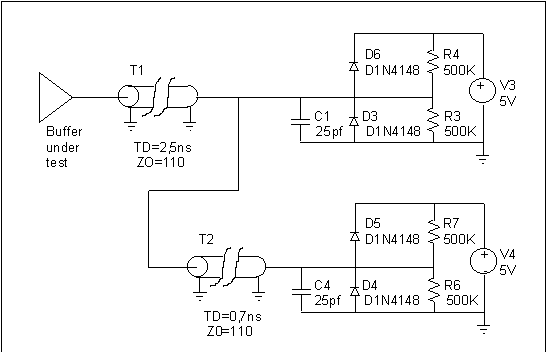

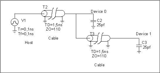

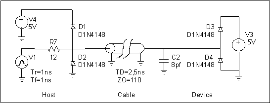

                  Figure C.5 – Schematic of SPICE simulation model

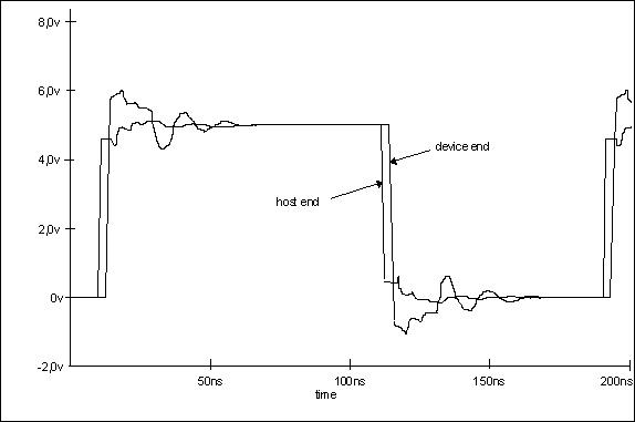

                  Figure C.6 – Simulation waveforms at host and device ends of cable
                  The simulation results in figure C.6 show the waveforms at both the host and device ends of the cable. The signal at the device end has ringing of sufficient amplitude to cause false triggering of the device. This is confirmed by transmission line theory which indicates that ringing will occur whenever the source impedance is lower than the characteristic impedance of the cable, and the termination is of higher impedance than the cable. The greater the mismatch, the greater the amplitude of the ringing. The oscilloscope trace shown in figure C.7 confirms the results of the simulations.

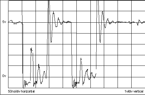

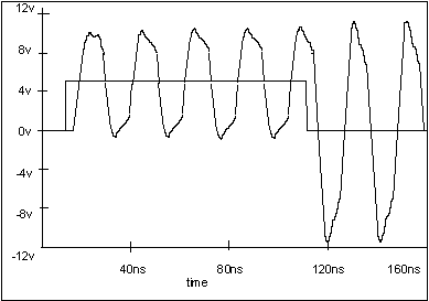

                  The latest trend in ATA interface chips has aggravated the ringing problem. In an effort to decrease propagation delay, some bridge chip manufacturers have increased the output drive current of the host in order to slew the output signal faster with the capacitive load of the cable. This has caused the edge rates and the output impedance to decrease, both of which increase the ringing at the device end of the cable. The oscilloscope trace in figure C.7 uses a generic driver and receiver – the problem of ringing is a fundamental characteristic of the ATA interface. This has not always been the case.
                  Figure C.7 – Oscilloscope trace at device end of DIOR- signal
                  on a typical system

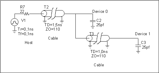

                8. A series resistor at the source (host) acts as a termination to the transmission line. When the value of the resistor matches the characteristic impedance of the cable (110 ohms) then the ringing is reduced to zero. Resistor values less than 110 ohms will partially terminate the cable and reduce the ringing.
                  Note C.3 - This assumes that the output impedance of the driver is zero. In reality, optimum match occurs when the output impedance and the series resistor together equal the cable impedance.
                  The ATA specification requires that a source sink 4 mA while maintaining a logical low output voltage of 0,5 V or less (See 4.3). Adding a series resistor in the output of the driver causes the output logical zero voltage to increase with greater resistance. For example, if the unterminated logical zero output of the driver is 0,4 V, then a maximum series resistance of 25 ohms is allowed ( (0,5-0.4)/4mA ). This DC voltage drop requirement acts in opposition to the higher resistance values required for cable termination. A five-percent, 22 ohm resistor meets the 25 ohm requirement. Note that this places an addition requirement on the host interface chip: timing measurements use a logical threshold of 0,4 V rather than 0,5 V as in the past.

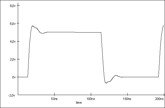

                  Is a 22 ohm resistor adequate for reducing the ringing? The simulation was repeated using the same model as shown in figure C.5 with a 22 ohm series resistor added. The results of that simulation appear in figure C.8. The ringing is significantly reduced from the previous simulation in figure C.6.
                  For maximum ringing it is assumed that the device(s) have CMOS input stages that do not provide significant DC loading. Yet for the series termination resistor calculation it is assumed a logical low sink current of 4 mA. Both of these conditions cannot simultaneously occur in practice, but assuming the worst-case sink current gives the best compatibility with older devices.
                  Figure C.8 – Waveforms with 22 ohm series resistor at source

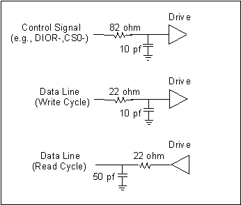

                15. C.2.7.1 Example of device-end termination timing
                16. Assume that 82 ohm series resistors are inserted on all receive signals and 22 ohm series resistors on all transmit and bidirectional signals. Also assume that the input capacitance of the interface chip is 10 pF. There are three different RC configurations that occur (see figure C.12). All receive signals will see an 82 ohm and 10 pF network. The data lines will see a 22 ohm and 10 pF network when the device is receiving data. Signals driven back to the host (including data lines during a read) will see 22 ohms and 50 pF. The 50 pF assumption is the worst-case condition of both the host and another device being located nearby (negligible cable length), and both of them having the maximum allowed input capacitance.
                  Figure C.12 – Signal models for device-end timing calculations
                  A simple SPICE simulation with a signal source and an RC load will show what the delays are through these three networks. Because the switching thresholds are not symmetrical with respect to the supply (0,8 V and 2,0 V) the delay for rising edges is different than that for falling edges. Since the input edge rate is unknown, both fast and slow edge inputs are simulated. The worst-case delay occurs with slow edges for rise times and fast edges for fall times. This mixture of slow rise time and fast fall time does not occur in real life, but since the edge speed is not known the worst case is planned for. The SPICE signal source is programmed for a rise time of 6,25 ns (same as 5 ns for 10% to 90%) and a fall time of 0,1 ns. The net result is six delay values. The results of the SPICE simulations are shown in table C.2.

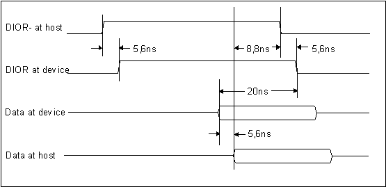

                  For example, consider the DIOW- Data Setup time (ATA value t3). This is the amount of time that the data must be stable before the rising edge of DIOW-. Assume that the interface chip has a value of 2,0 ns. It is known that DIOW- is a control signal and the rising edge of control signals are delayed by 0,9 ns. This means that the setup time at the chip is actually greater than expected. But the data is delayed too. It is not known what the data pattern is so it is assumed that the delay time is the maximum of Tphldi and Tplhdi. The actual setup time is 2,0 + 0,9 - MAX(0,3, 0,5) = 2,4 ns. This is less than the ATA requirement of 30 ns (for PIO Mode 3) and therefore within spec.
                  This careful thought process must be repeated for all fifteen of the ATA PIO timing parameters (and for DMA also). The easiest way to do this is to make a spreadsheet and enter the six values for RC delay and the interface chip timing parameters. Spreadsheet formulas can then compute the timing at the pins of the device and highlight any that are not within spec. In this manner the difficult calculations need only be derived once and it becomes easier to verify results.

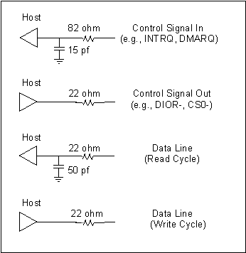

                18. The host-end timing calculations are similar to the device-end calculations described above with a few more complicating factors added in. The four different signal configurations are shown in figure C.13. For this design 82 ohm series resistors are used on control lines received by the host and 22 ohm resistors on the data lines and control lines driven by the host. It is assumed that the host adapter chip input capacitance plus stray capacitance is 15 pF.
                  Figure C.13 – Host-end signal configurations with terminations
                  For these values, the control signal out and the data out models look the same. One simulation can be used to determine both values. The greatest uncertainty is the delay through the cable for received signals. The total cable delay depends on the source impedance of the device. This can be anything from zero to 82 ohms; the greater the impedance, the greater the delay. It is assumed for this example that the device vendor has read this document and has decided to use 22 ohms resistors. If it is desired later to make a worst-case assumption of 82 ohms, then approximately 2 ns are added to the numbers.
                  Using SPICE models similar to the one shown in figure C.14 the eight delay parameters required are derived. A second device appears in the model as a lumped capacitance of 25 pF which causes the maximum delay. The resulting values appear in table C.3. By examining the values in the table it should be clear why the cable propagation delay is often referred to as being about 5 ns.
                  Figure C.14 – SPICE model for control signal out delay calculation

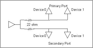

                19. C.2.8 Dual port cabling
                One of the recent enhancements to the ATA bus has been the use of primary and secondary ports, allowing the user to attach up to four devices. The optimal way to implement dual ports is to have two completely separate interfaces that have no circuitry in common. This guarantees isolation between the ports and insures that no interference will occur.

                The advent of local bus bridge chips has introduced new driving forces to the dual port cabling issue. Implementing two independent ATA ports on a single chip requires 66 I/O pins. Due to the cost of pins, some designs have combined the data lines of the two ports into one set of pins. Sharing the data lines (or any other lines) in this way without termination is asking for trouble. Simulations confirm that the ringing in such configurations is large and complex, particularly if the loads on the two cables are not balanced.
                One alternative pin-saving solution would be to add a set of external buffers. This would require three new control lines but would save sixteen data lines for a net improvement of thirteen pins. This also would require additional packages on the circuit board.
                An economical solution is to add independent series resistors for each line (see figure C.15). Energy reflected back from the first cable passes through one termination resistor before getting to the host. The reflected signal is further attenuated as it passes through the second resistor and into the second cable. This signal is reflected from the end of the second cable (with loss), and must pass through the termination resistor again before arriving at the host. This provides sufficient attenuation of reflected signals.
                Figure C.15 – Preferred connection for shared lines in dual port systems
                Not all of the signal lines in a shared dual port interface can be shared. If the chip selects (CS0-, CS1-) and the data strobes (DIOR-, DIOW-) are shared, then it is impossible to differentiate between the primary and secondary ports. A write to a device on one port causes the same action to occur on the other port, destroying the data on the other device. The data strobe lines are sensitive edge-triggered signals while the chip selects act more like level-sensitive address lines. It is recommended that designers share the less sensitive chip selects and not share the data strobes.
                Table C.4 makes some assumptions about how the dual porting is being implemented. If the data lines are shared, there are not simultaneous accesses to the primary and secondary ports. This in theory allows the DMACK- and IORDY lines also to be shared. The INTRQ and DMARQ signals are driven by tristate buffers on the devices. Either the master or slave enables its tristate driver depending on the state of the DEV bit in the Device/Head Register. Therefore INTRQ and DMARQ cannot be shared because either the master or slave device will be driving these lines at all times. The primary port devices do not know about the secondary port devices, so sharing these lines would create a conflict. In theory the DMACK- line could be shared since it is driven by the host. In practice this is not recommended. It is likely that some devices respond unconditionally to the DMACK- signal, whether they ever requested a DMA cycle or not. This could lead to a conflict on a DMA cycle between a primary port device and a secondary port device during the data cycle. For these reasons the INTRQ, DMARQ, and DMACK- lines cannot be shared.

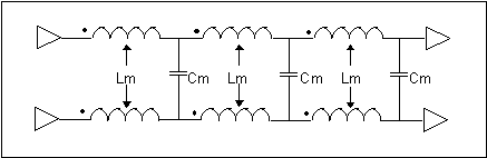

              4. Crosstalk is switching on one signal line causing induced signals in an adjacent line. Crosstalk has not been a significant issue in the past with slower edge rates; in newer systems the problem is often masked by ringing. Once the cable is terminated and the ringing is under control, then the presence of crosstalk becomes apparent.
                1. C.3.1 Coupling mechanisms
                There are two mechanisms by which a signal couples into an adjacent line. The first is coupling capacitance, and the second is mutual inductance. As a switching signal wavefront propagates down the cable it couples energy into the adjacent line. Once this energy is in the second transmission line, it propagates in both directions: forward toward the receiver and back toward the source (see figure C.16).
                First the forward coupling components are examined. The voltage induced in the second transmission line is proportional to the coupling coefficient, the inductance, and the rate of change of current in the primary side. This is a negative voltage: a positive current spike in the primary line results in a negative voltage spike in the secondary line.
                The coupling capacitance between the two line causes a current pulse in the secondary line proportional to the capacitance and the rate of change of voltage on the primary side. A positive voltage step on the primary line causes a positive voltage spike on the secondary line.
                Figure C.16 – Crosstalk coupling mechanisms
                These two coupling mechanisms have some interesting characteristics. The polarity of the coupling is opposite for the mutual inductance and coupling capacitance. If the magnitudes of these effects are comparable, then they will cancel, resulting in no forward crosstalk. Unfortunately, accurately computing these values is difficult, and the easiest way to determine the actual amount of crosstalk is to measure it. The other noteworthy characteristic is that the magnitude of the coupled signal is proportional to the rate of change of the signal in the primary line. This is a major reason for controlling the slew rate on ATA bus drivers. Earlier it was said that ringing on the data lines is not necessarily a problem. Here it is seen that fast edge rates and ringing on the data lines can couple by crosstalk into adjacent control lines, causing control sequence errors through mistriggering. It is unlikely crosstalk from data lines causes observable failures in a laboratory environment. But the presence of crosstalk-induced voltage spikes on the control signals reduces the noise margin, and can increase the long-term error rate.
                The amplitude of the coupled signal is proportional to the total amount of coupling capacitance and mutual inductance, and is therefore proportional to cable length. Once a line is terminated properly, ringing is no longer a function of length. This leaves crosstalk as the major factor limiting cable length.
                Reducing crosstalk involves reducing the mutual inductance, reducing the coupling capacitance, or decreasing the source signal amplitude. Controlling the inductance and capacitance can be done by either keeping the length of the cable short or by increasing the distance between conductors. Placing a ground conductor between critical signals increases the separation of the signals and also adds a shielding effect from the intervening ground. In the ATA environment the only control that can be exercised over the cable is to keep the length at 18 inches or less. The amplitude of the source signal cannot be reduced and still maintain ATA compatibility, but there is control over some elements of the source signal. Slew rate limitation reduces the high-frequency components of the source signal and therefore reduces the coupling of these components into adjacent lines. Terminating the lines reduces ringing which also decreases the amount of energy coupled at the ringing frequency.

                2. The most significant timing issue is the propagation delay of the cable. This needs to be added to the host-side timing. The SPICE model in figure C.17 shows an unterminated host with very fast rise times driving a cable with worst case loads. Two unterminated devices are assumed with the maximum allowed capacitive loading of 25 pF.
                  Note C.9 - 25 pf was specified in ATA-2.
                  The simulation results are shown in figure C.18. The period of the ringing is four times the propagation delay of the cable. This simulation shows a cable propagation delay of 5.6 ns. This is twice the value obtained by assuming an 18-inch cable with a propagation velocity of 60% c. The additional delay is due to the presence of the capacitive loads on the cable. This result is important to system designers who take into account worst-case cable delay when specifying the bridge chip timing.
                  Figure C.17 – SPICE model of ATA cable with worst case loads
                  Figure C.18 – Simulation of unterminated ATA cable with worst case loads
                  From the host point of view, all of the ATA timings are corrected by adding the propagation delay of the cable to insure that the timing is correct at the input pins of the furthest device. Figure C.19 shows a typical corrected result using the read cycle data setup time as an example. The ATA document specifies a setup time at the device of 20 ns (PIO Mode 3). The remaining setup time at the host is only 8,8 ns (20 - 2 x 5,6).
                3. C.4.2 The influence of termination
                4. If the host has a series partial termination resistor then the bridge chip includes additional timing margin to account for the RC delay of that resistor. Simulations show that the incremental delay added by a series termination resistor at the host is approximately 0,1 ns for a 22 ohm resistor and 1,7 ns for an 82 ohm resistor.
                  Note C.10 - Assuming Two drive load, 25 pF at each drive, 18-inch cable, 25 pF at host
                  The extra delay of higher resistor values is one of the reasons that 22 ohm series resistors at the host are recommended.
                  Figure C.19 – Host data setup time during a read cycle
                  The series resistor at the host is located as close as possible to the ATA connector. To see the importance of this, SPICE simulations are done with the stray capacitance on the driver side of the series resistor and again with the stray capacitance on the cable side. The ringing is reduced when the stray capacitance of the host is on the driver side of the series resistor. A related issue is the distance from the host adapter chip (or chipset) to the ATA connector. Some motherboards have the chip located up to 10 inches away from the connector. This effectively adds another 10 inches to the 18-inch ribbon cable, resulting in an equivalent cable length of 28 inches.
                  Note C.11 - The traces on the circuit board are from 50 to 200 ohm impedance, so the electrical length of the trace cannot simply be added to the 110 ohm ribbon cable. A SPICE simulation can be used to find the actual delay.
                  This additional length is not necessarily a problem. If the system manufacturer takes the extra trace delay into account in the application of the host adapter chip, and the total capacitance is kept below the ATA host limit of 25 pF, then in theory there is no difference. Real-world experience indicates that this calculation is rarely done. The distance from the chip to the connector is not addressed in the ATA specification. Keeping the connector within 3 inches (by trace length) of the host adapter chip is recommended.
