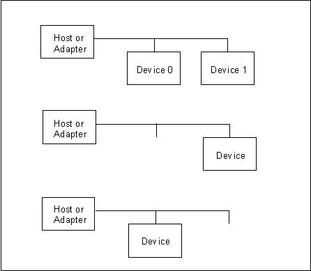

      1. Cable configuration
This standard defines the ATA interface containing a single host or host adapter and one or two devices. If two devices are connected to the interface, they are connected in a daisy chained configuration. One device is configured as Device 0 and the other device as Device 1.
The designation of a device as Device 0 or Device 1 may be made in a number of ways:
In a two drive configuration, a device shall be at one end of the ATA interface cable and the host shall be placed at one end of the cable.
It should be recognized that if a single device is configured at the end of the cable using CSEL, a device 1 only configuration will results. If a single device configuration is implemented with the device in the middle, a cable stub results that may cause degredation of signals. Also see 5.2.15.
Figure 1- ATA interface cabling diagram
