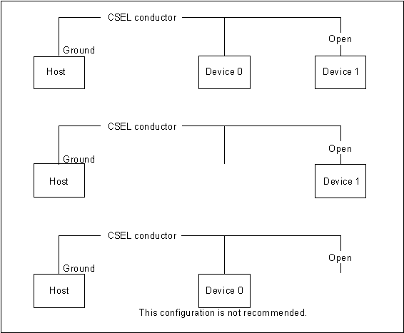

          9. CSEL (Cable select)
    This signal shall have a 10 kW pull-up resistor at each device.
    The device is configured as either Device 0 or Device 1 depending upon the value of CSEL:
    CSEL shall be maintained at a steady level for at least 31 s after the negation of RESET-.
    Note 3: Special cabling can be used by the system manufacturer to selectively ground CSEL e.g., CSEL of Device 0 is connected to the CSEL conductor in the cable, and is grounded, thus allowing the device to recognize itself as Device 0. CSEL of Device 1 is not connected to CSEL because the conductor is removed, thus the device can recognize itself as Device 1.
    Figure 2 - Cable select example
