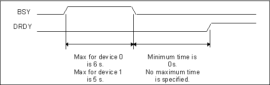

          DESCRIPTION - This command shall perform the internal diagnostic tests implemented by the device. See also 6.2.9 and 6.2.13. The DEV bit in the Device/Head register is ignored. Both devices, if present, shall execute this command.
          Device 0 performs the following operations for this command:
          a)Device 0 sets the BSY bit within 400 ns after the EXECUTE DEVICE DIAGNOSTIC command is received;
          b)Device 0 performs diagnostics;
          c)Device 0 resets the Command Block registers to the following:
          Cylinder Low
          00h
          Cylinder High
          00h
          Sector Count
          01h
          Device/Head
          00h
          Sector Number
          01h
          d)Device 0 posts diagnostic results to bits 6-0 of the Error Register;
          e)If Device 0 detected that Device 1 is present during the most recent power on or hardware reset sequence, then Device 0 waits up to 6 s from the time that the EXECUTE DEVICE DIAGNOSTIC command was received for Device 1 to assert PDIAG-. If PDIAG- is asserted within 6 s, Device 0 clears bit 7 to zero in the Error Register, else Device 0 sets bit 7 equal to 1 in the Error Register.
          If device 1 was not detected during the most recent power up or hardware reset sequence, then Device 0 clears bit 7 to zero in the Error register;
          f)Device 0 clears the BSY bit when ready to accept commands that do not require the DRDY bit to be equal to 1.Device 0 shall clear the BSY bit within 6 s from the time that the EXECUTE DEVICE DIAGNOSTIC command was received;
          g)Device 0 sets the DRDY bit when ready to accept any command.
          NOTE 13: Steps f) and g) may occur at the same time. While no maximum time is specified for the DRDY bit to be set to one to occur, a host is advised to allow at least 30 s for the DRDY bit to be set to one. See Figure 7.
          Device 1 performs the following operations for this command:
          a)Device 1 sets the BSY bit within 400 ns after the EXECUTE DEVICE DIAGNOSTIC command is received;
          b)Device 1 negates PDIAG- within 1 ms after the command is received;
          c)Device 1 performs diagnostics;
          d)Device 1 resets the Command Block registers to the following:
          Cylinder Low
          00h
          Cylinder High
          00h
          Sector Count
          01h
          Device/Head
          00h
          Sector Number
          01h
          e)Device 1 clears bit 7 of the Error register to zero and posts its diagnostic results to bits 6 through 0 of Error register;
          f)Device 1 clears the BSY bit when ready to accept commands that do not require the DRDY bit to be equal to one;
          g)If Device 1 passed its diagnostics without error in step c), Device 1 asserts PDIAG-. If the diagnostics failed, Device 1 does not assert PDIAG- and continues to the next step;
          NOTE 14: Device 1 shall clear the BSY bit and assert PDIAG- within 5 s of the time that the EXECUTE DEVICE DIAGNOSTIC command is received.
          h)Device 1 sets the DRDY bit when ready to accept any command.
          NOTE 15: Steps f), g) and h) may occur at the same time. While no maximum time is specified for the DRDY bit to set to one, a host is advised to allow at least 30 s for the DRDY bit to be equal to one. See Figure 7.
          Figure 7 - BSY and DRDY timing for diagnostic command
