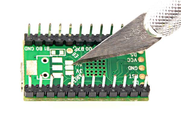

Option #1: Cut "5V" Pads Apart
Cutting the trace that connects the "5V" pads will isolate the USB power from the rest of the circuit board. Please refer to the schematic for details. If the original connection needs to be restored, the pads can be soldered together.
