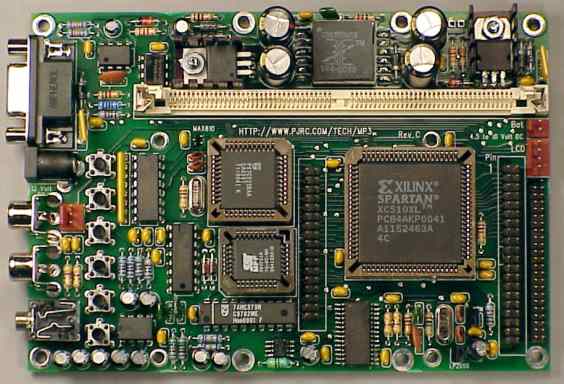

![]() Here is a larger photo (120k). We'll be shipping boards and kits tommorrow, and this first small batch should cover most, if not all of the backorders. I'll be posting info about the new rev C to the technical docs section over the next week, but for now Robin and I are tired and need to take a little break! October 10, 2001: Well, I've missed the deadline to get the first 20 rev C boards made by Saturday (Oct 13), but it looks very good for getting them sometime next week. One really positive thing that's come out of this long process is that I've finally drawn a reasonable schematic for the first board. Well, it's missing the pushbuttons and serial interface, but that'll be easy to add. Getting all those connections checked was a lot of work, as you can see from that image. I know there's a good number of people (several are students) who've been waiting for the schematic for quite a while, so enjoy. Rev C makes only a couple minor tweaks to the main schematic, so it'll be relatively easy to get a complete rev C schematic up by the time we're shipping boards. Also, I should mention that I've fallen behind in answering emails (worse that usual...) Please be patient, I will try to answer them all, probably next week while the boards are getting fabricated and we're making the inevitable last-minute orders for a few missing parts. October 4, 2001: It probably seems like I've dropped off the face of the earth... no updates to this page, not much happening with the firmware lately, ran out of mp3 player circuit boards, etc. Well, here's a bit about what's been going on lately. We ran out of boards about 5-6 weeks ago, and once more I was faced with the decision, "should I just make more of the exact same board, or should I try to improve the design". As you may know, I've never been 100% happy with the power supply part of the board. Rev A worked, though not nearly as efficiently as I wanted. Rev A also has a 4.5 to 6 volt input, and it was easy to damage the board by applying more than 7 volts to this input. I made some minor changes to create rev B with a sturdy 6 to 10 volt input (in addition to the 10-15 volt input), and the change reduced the heating in the TIP102 transistor. Still, it seem like it ought to be possible to do better. Well, it isn't easy. Over the last several weeks I've made multiple attempts that turned out to be dismal failures at a better power supply. I was about to give up. I took one more shot at it, and finally a result that I think is pretty good has come about. Here's a photo of the prototype:
![]() This supply uses a lot of the same parts as rev B, but the performance is considerably improved. The higher voltage input is still 10 to 15 volts, with protection from the nasty spikes from a car's alternator. The low voltage input is now 4 to 10 volts, which means rev C will be able to run from four AA batteries like rev A, but will be sturdy like rev B. Rev C's battery input will be much more efficient that either rev A or rev B... I wanted to be close to 100% efficient, but that's nearly impossible for a supply that can step up or step down as needed. I made many attempts to get really high efficiency, some using lots of expensive parts, but in the end none worked really well. I talked with a guy who's an expert at switching power supplies, but all his ideas revolved around complex custom transformers and inductors. I tried contacting some of the companies that make these. Most won't touch it for under 5000 parts/year, and those that will are very expensive for qty 100-200. So it looks like the standard parts (Cooper/Coiltronics) will have to do. I think this rev C supply is a good compromise and it keeps the cost and total size about the same as rev B. One of the major changes is a new PWM control chip. This new part (TL5001) includes a sort start limiter, which will eliminate the problem were the board can trip the current limiting that's built into many lab bench power supplies (not an issue for batteries and "wall warts"). The new switching supply makes only +5 volts, and a LP2950 linear regulator makes the 3.3 volts. Creating only +5 volts allows the supply to make better use of the transformer, and I switched to a somewhat smaller transformer (less magnetic material = lower losses is the core, which more than makes up for the small loss in the LP2950 for 3.3 volts). I also did a little trick to use the flyback voltage to create a little higher drive voltage for the mosfet, which really helps reduce the heating in the mosfet (and improve efficiency) when the supply is run from only 4 volts. There's also an undervoltage lock-out and a max duty cycle limiter so that the supply acts much more gracefully as the battery voltage falls below 4 volts. I also overhauled the circuit that muxes the 12 volt and battery inputs and protect from car alternator noise while preventing the battery from seeing destructive overcharging. The rev A and rev B versions used a diode in series with the battery, which really cuts into the battery's run time. The rev C design uses a P-channel mosfet (it's on the bottom of the prototype board) to eliminate the loss from that diode. I think that's most of the changes... all in all, it's quite an improvement over rev A and rev B. Though not as ambitious as my first couple (failed) attempts, I think it's pretty good and it'll fit into the existing board size without changing the cost of the board much (we'll keep the price the same at $150). A major frustration in this project has been the CAD software. The program I used for rev A and rev B is having a lot of trouble (corrupted files, bogus gerber output, etc). It really sucks to have to redraw an entire board with this many connections, but that's exactly what I had to do. Luckily I have access to some better software now, which has its own set of minor problems, but at least it seems to have a solid database and file format behind it. I'm going to avoid mentioning names, but I will say that the really problematic program was one of the really inexpensive packages. I guess you get what you pay for... So the big question is when will these rev C board be available. I wish I had an exact date. Today the new transformers finally arrived. We're still missing some of the important parts, but have a small number of them left over from rev B. I talked with the board fab company and they can get us a small number of boards in a hurry (for an extra fee, of course). We're going to try to get the first rev C boards and kits shipped on Oct 15. I know we have a few folks waiting who're using the board as part of a project with an urgent deadline. We're going to try to ship to them and the people who've been waiting more than 2 weeks. We'll get the rest of the boards and have them built later in the month... so hopefully we can have all the backlog taken care of before Halloween (Oct 31). I probably won't manage to get much done on the firmware until the boards and kits are sitting in stock and all the orders are shipped. One exception to this is the display beta test. Tom did a lot of work on the display firmware a couple months ago, and I made some small changes to fix the 2-pixel-shift bug and other random drawing bugs. Tom's new code includes some changes to make the display update better with less communication bandwidth from the player, but there's one more bug in this new code that prevents it from really improving the redraw responsiveness. Tom has been on a vacation for a couple weeks but recently returned. He'll probably look into this soon, and either way I'll do some work with the display firmware so that when we have the board again later this month, we'll have displays with the new debugged and improved code on them (the display is not easily upgradable like the player is). So that's more or less where the project is at. I am alive and well, but quite busy trying to get everything put together to finally have rev C boards available. Hopefully next month we'll have plenty of boards again and I can get back to working on the firmware and doing much-needed updates to the web site. August 24, 2001: It's been a few weeks since I've added any updates here. I'm going to try to get an update up here at least once a week. It's been almost exactly 2 months since the firmware development was moved to CVS, and during that time several people have come on board and really helped fill out a lot of the player's features. Ian did quite a bit of work to add items to the display, including interactive tone controls. Zach added code that scans all the directories on the drive. I overhauled the device drivers to speed this up, and Matthew has done quite a bit of work to optimize this. He also began some of the initial coding to be able to read .m3u files, but much remains to be done there. Matthew also made several valliant attempts to make that code non-recursive (allowing almost limitless subdirectory depth to be scanned), but that's a difficult task. I did some optimizing and improved the recursive version, so we can at least scan 5-6 levels deep. Somewhere in there I spent a very frustrating week or so chasing after the bug that makes the player lock up eventually, but it still ellludes me. Early on, Ian had written some code to find ID3 tags. I fixed a couple bugs, and then Ian, Chris, Matthew and others did quite a lot with ID3 tags, and today's firmware displays the ID3 info on the LCD. Zac joined the group and fixed a long-standing bug in my I2C driver code. Zac then added an nice elapsed time display, where "--:--" had always been, and he did some cleanups and improvements to the ID3 parsing code. Matthew did some more work to try to process .m3u playlist files, but this really needs more support from the drivers. I added a driver function to allow memory mapping 4k sections files, but more library-level support is needed for parsing before .m3u processing can happen in a reasonable efficient manner. Chris added more play modes, sequential in just one directory or the whole drive, random in directory or whole drive, etc. Chris also added a resume feature, where the player will usually remember where it was in the list and start there again when it is used again after a shutdown. Tom has been working on adding some cool features to the display board code. I did some testing and fixed the shift-by-two-pixels bug in the display, and Tom has added a freeze/unfreeze feature that should make updates flicker less. Tom also put in support for scrolling directly in the display, which will cut down on the excessive data trasfer to the display. I believe this is most of what's happened in the last month, but it's hard to recall everything in detail... If I've missed something that anyone contributed, please let me know. So what's next? Well, it's becoming clear that soon there needs to be a new official firmware rev, even if we can't call it "stable". In firmware development, probably the next major thing will be an overhaul of the main playback state machine. This is no small task. Eventually this would enable playing files larger than the SIMM, and probably also use the avaialble memory better, perhaps to read ahead into the next file if there is a lot of memory, perhaps to read the first part of many upcoming and/or previous files to have rapid response to the pushbuttons. There's also the task of reading .m3u playlists, ID3v2 tags, fast forward/rewind, more LCD stuff... the list goes on and on. Actually, there is a file in the firmware source called "wish_list.txt" which is more or less the official list of requested features. This list is writable only to developers with CVS commit access, mainly so that ideas are filtered through developers who have an idea of what is and isn't feasible. All developers are welcome to add to the list (or remove as things are implemented). On the less technical front, we ran out of circuit boards a few days ago. We're working to get more made, but it will be a couple weeks. It'll also consume some of my time, so I won't be doing as much work on the firmware until they're done. The final thing that's going on it pjrc.com will be moving to a different ISP. There will be a couple weeks of overlap, so with some luck things will go smoothly with the DNS and there won't be any down-time (I hope). The new server will be at a data center with very high speed connections to the net, so viewing pjrc.com should become noticably faster if you have a broadband internet service. It should also be much more reliable that what we've been using. August 5, 2001: Today I spent the whole day writing a dir_read_fast function which is an attempt to make a much faster directory read. If you've tried 0.6.3.3 or the recent CVS versions, you know that they scan all the subdirectories on the drive (up to some level, currently 3 deep in today's CVS code). Today this is slow. This new fast directory read should make a big difference. Right now it's very new and not used by the directory scanning code (it's API is a bit different). Also, if you haven't been keeping up with the latest CVS code, about a week ago Matthew and Ian got ID3 tag display working. All of the 8 lines of the display now do something. I want to make an official release on the firmware page, but it will have to wait as I spent the entire day doing the new fast directory reading code. July 25, 2001: Quite a bit has happened in the last 24 hours! I haven't had much time to work on the project for the last few weeks, and the firmware hit a limit called DSEG overflow which prevented anyone from doing much. A couple days ago I wrote a perl script that checks the DSEG usage and I made a bunch of small improvements to make more DSEG space. Matthew added display of which directory is being played. Ian committed some bug fixes. Quite some time ago Ian wrote code to read the ID3 tag, but until last night it wasn't finding the correct place in the file. I fixed that, and then Matthew picked it up and added parsing and display of the ID3 tag info (title, album, artist). There's been some fiddling with optimizing the directory scanning code, and it was broken for a while but looks like it may be fixed now. Things are really moving. If you want to try out this cool new stuff, grab the source code from CVS, or download from Jim's automatically updated compiled images. If there aren't any major bugs, I'll make rev 0.6.3.4 over the weekend. June 30, 2001: Zach added code that plays all the MP3 files on the drive, not just the root directory! Ian added adjustment of the bass and treble roll-off frequencies. I've been quite busy lately had haven't even been able to keep up with my email and the yahoo group. Today I included Zach's new code. I probably won't have much time for this project until July 4. If you've sent me an email and I haven't answered, please try to wait until the 4th to remind me. June 26, 2001: I stayed up late and did some investigation into why some newer SIMMs are incompatible with the player. The short story is that there is both good news and bad news. First, the good news is it looks like I'll be able to improve the SIMM detection code to make these newer SIMMs work properly. But, the bad news is that the hardware was designed around the older style of SIMM and only a portion of newer SIMMs will be usable with the player. Here are some photos of both types of SIMMs. I have an archived copy of the datasheet for the older SIMM type. When I designed the board, this was the only datasheet I could find on-line. The four chips on that newer SIMM shown below are Samsung KM48C8000, and I was able to find someone's old copy of the datasheet (google is great!). Using the datasheet for the chips and some reverse engineering with an ohm meter, I was able to learn a bit about these newer SIMMs. Using today's firmware (0.6.3.2), this newer 32 meg SIMM is detected as 8 megs, and the player attempts to use it and crashes (because only 4 megs is actually usable).
