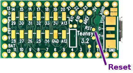

Reset Signal
Teensy 3.0 supported both a Program signal, to reboot into bootloader mode, and a traditional Reset signal, for a conventional reboot that restarts your application.The Reset signal can be found on a new test point on the bottom side of Teensy 3.1.
![](teensy31_back_reset.jpg)
The Reset signal is also available at a test point on the bottom side of Teensy 3.2.
![](teensy32_back_reset.jpg)
