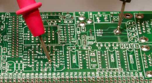

Reset Signal
The 87C52 uses an "active high" reset signal. This means the 87C52 does not execute code when the reset signal is high, and it begins running code when this signal goes from high to low.
Multimeter leads on RST pin of 87C52 and ground
Figure 1: Measuring The Reset Signal at RST Pin on 87C52 Chip
The reset signal can be verified by measuring the voltage on the RST pin of the 87C52, as shown in Figure 1. This is much easier if an aligator clip is used to secure the negative lead to the screw mounting the 87C52, so one hand is free to press the reset button.
When the reset button is pressed, the RST pin should measure 5 volts DC. When the button is released, it should go back to zero. The resistor-capacitor circuit that creates an initial reset pulse on startup can be "seen" on multimeters with a faster response time. Usually the multimeter's auto-ranging feature must be disabled. The voltage makes a transition from 5 to 0 volts with a time constant of 0.1 seconds. Most multimeters will display 1, 2 or 3 readings between 5 to 0 volts just after the button is released.
