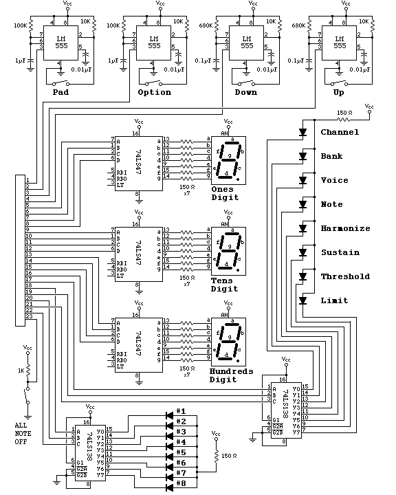

Front Panel Schematic (and board layout)
Note: the new front panel board will use shift register chips to obtain all the LED output data, so that only 8 signal lines will be needed between the boards. The new boards will use a dual-row 16-pin header (more pins for power this time), so it'll be easier to interconnect the boards with nice ribbon cable and standard IDC connectors. The shift registers should also make it easy to add more LEDs to the design.
Front Panel Schematic:
schematic diagram
TODO: add some explaination, though this circuitry is pretty simple.
