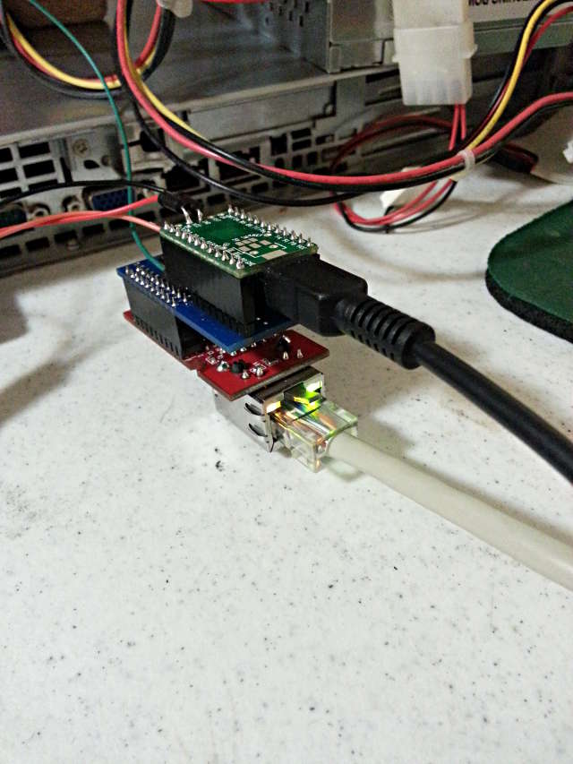

[This photo] shows the teensy 2.0 adapted with one of your wiz812 adaptor kits. Then adapted to the wiznet 5100 network adaptor.
From the picture you can see that I soldered a few test leads right into the teensy. These leads power the opto-isolator.
[This photo] shows the whole view. The teensy to the wiznet to the opto-isolator (the black electrical tape bundle)
This then goes to a 5v relay which acts like a switch on a computer case (the two left most blue wires on the motherboard). The teensy has enough power to switch the relay (but i had to put a current limiting resistor inline with the teensy output pin. It was drawing over 50mA, and according to the electrical specs from atmel, 40mA is max)
The two right leads that you see on the motherboard are for the computer power led. They give 5v signal back to the teensy so that i can tell on the web interface if the computer has shut off like i want it to.

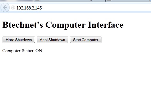

I have also included a screenshot of my web interface.
At the moment it includes a hard shutdown (equivalent to holding the power button in to shut the computer down). Includes a ACPI shutdown (equivalent to momentary hitting the button to shutdown the OS), and a start computer button (which is effectively the same as as acpi shutdown, since it does the same thing.)
