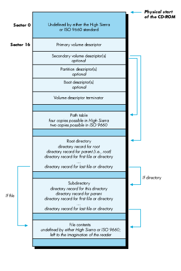

THE LOGICAL FORMAT
CD-ROMs are laid out in 2048-byte physical sectors. This physical layout is defined in a standard published by  Philips and Sony known as the Yellow Book, and is independent of the type of volume formatting used. Under ISO 9660 and High Sierra, the CD is also laid out in 2048-byte logical sectors. Both formats also have the  concept of a logical block, which is the smallest chunk of file data. A logical block can be 512, 1024, or 2048   bytes. In general, file access information is laid out in sector-sized units, while actual file data is laid out in  block-sized units. On most CDs, the block size is the same as the sector size at 2048 bytes, so this distinction  isn't important. Figure 1 shows the layout of a volume in ISO 9660 or High Sierra format.
Figure 1: A Volume in ISO 9660 or High Sierra Format
THE VOLUME DESCRIPTORS
Information about the volume itself is contained in an array of 2048-byte entries, beginning at logical sector 16  on the disc, as shown in Figure 1. These are the volume descriptors. There are five types of volume  descriptors: the primary volume descriptor, the secondary volume descriptor, the boot descriptor, the partition  descriptor, and the volume descriptor terminator. Every volume descriptor is 2048 bytes long (one sector). The first descriptor in the array is always a primary volume descriptor, and the last descriptor always a volume  descriptor terminator. The other three volume descriptor types are optional. The boot descriptor and the  partition descriptor aren't supported by the Macintosh, because the Macintosh boot code looks at the beginning  of the disk for boot tracks, not at sector 16.
Each volume has one and only one primary volume descriptor. This descriptor consists of the volume name,  some publishing information, and offsets to the path table and root directory. The primary volume descriptor also contains a copy of the root directory entry (to minimize the number of seeks necessary to find out  information about a disc). In the directory structure pointed to by the primary volume descriptor, filenames can consist of the uppercase characters A through Z, the underscore, and the digits 0 through 9. This is a subset of ISO 646, an international character representation standard roughly equivalent to ASCII. You will see a sample  primary volume descriptor later in this article in the section entitled "A Simple Formatting Program: ISO 9660 Floppy Builder."

The volume descriptor terminator is a simple structure that serves to indicate the end of the volume   descriptor array. Each volume contains one, and only one, volume descriptor terminator.
THE PATH TABLE
The path table describes the directory hierarchy in a compact form, containing entries for each of the volume's directories. Its purpose is to minimize the number of seeks necessary to get to a file's directory information. The Macintosh caches the path table in memory, enabling  to any directory with only a  single seek.
ISO 9660 allows up to two identical copies of the path table to be stored on the disc, while High Sierra allows  up to four copies. This is useful to operating systems that do not cache the path table in memory. In this case,  copies of the path table can be stored at regular intervals on the disc--say a quarter of the way in and again   three-quarters of the way in--to decrease the seek time necessary for the optical read head to find one of the  copies.
