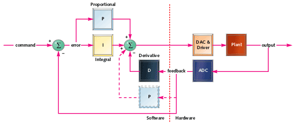

PID control
The PID controller has been in use for over a century in various forms. It has enjoyed popularity as a purely mechanical device, as a pneumatic device, and as an electronic device. The digital PID controller using a microprocessor has recently come into its own in industry. As you will see, it is a straightforward task to embed a PID controller into your code.
PID stands for "proportional, integral, derivative." These three terms describe the basic elements of a PID controller. Each of these elements performs a different task and has a different effect on the functioning of a system.
In a typical PID controller these elements are driven by a combination of the system command and the feedback signal from the object that is being controlled (usually referred to as the "plant"). Their outputs are added together to form the system output.
Figure 1: A basic PID controller
Figure 1 shows a block diagram of a basic PID controller. In this case the derivative element is being driven only from plant feedback. The plant feedback is subtracted from the command signal to generate an error. This error signal drives the proportional and integral elements. The resulting signals are added together and used to drive the plant. I haven't described what these elements do yet-we'll get to that later. I've included an alternate placement for the proportional element (dotted lines)-this can be a better location for the proportional element, depending on how you want the system to respond to commands.

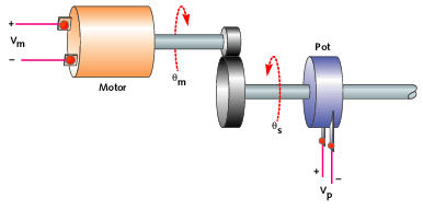

Motor and gear
The first example plant is a motor driving a gear train, with the output position of the gear train being monitored by a potentiometer or some other position reading device. You might see this kind of mechanism driving a carriage on a printer, or a throttle mechanism in an automobile cruise control system, or almost any other moderately precise position controller. Figure 2 shows a diagram of such a system. The motor is driven by a voltage that is commanded by software. The motor output is geared down to drive the actual mechanism. The position of this final drive is measured by the potentiometer.
Figure 2: A voltage driven motor and gear train
A DC motor driven by a voltage wants to go at a constant speed that is proportional to the applied voltage. Usually the motor armature has some resistance that limits its ability to accelerate, so the motor will have some delay between the change in input voltage and the resulting change in speed. The gear train takes the movement of the motor and multiplies it by a constant. Finally, the potentiometer measures the position of the output shaft.
Figure 3: Motor and gear position vs. time
Figure 3 shows the step response of the motor and gear combination. I'm using a time constant value of t0 = 0.2s. The step response of a system is just the behavior of the output in response to an input that goes from zero to some constant value at time t = 0. Since we're dealing with fairly generic examples here I've shown the step response as a fraction of full scale, so it goes to 1. Figure 3 shows the step input and the motor response. The response of the motor starts out slowly due to the time constant, but once that is out of the way the motor position ramps at a constant velocity.

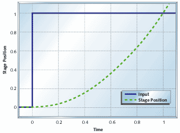

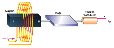

Precision actuator
It is sometimes necessary to control the position of something very precisely. A precise positioning system can be built using a freely moving mechanical stage, a speaker coil (a coil and magnet arrangement), and a non-contact position transducer.
Figure 4: A precision actuator
You might expect to see this sort of mechanism stabilizing an element of an optical system, or locating some other piece of equipment or sensor. Figure 4 shows such a system. Software commands the current in the coil. This current sets up a magnetic field that exerts a force on the magnet. The magnet is attached to the stage, which moves with an acceleration proportional to the coil current. Finally, the stage position is monitored by a non-contact position transducer.
With this arrangement, the force on the magnet is independent of the stage motion. Fortunately this isolates the stage from external effects. Unfortunately the resulting system is very "slippery," and can be a challenge to control. In addition, the electrical requirements to build a good current-output amplifier and non-contact transducer interface can be challenging. You can expect that if you are doing a project like this you are a member of a fairly talented team (or you're working on a short-lived project).
Figure 5: Precision actuator position vs. time
The equations of motion for this system are fairly simple. The force on the stage is proportional to the drive command alone, so the acceleration of the system is exactly proportional to the drive. The step response of this system by itself is a parabola, as shown in Figure 5. As we will see later this makes the control problem more challenging because of the sluggishness with which the stage starts moving, and its enthusiasm to keep moving once it gets going.

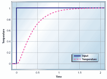

Temperature control
The third example plant I'll use is a heater. Figure 6 shows a diagram of an example system. The vessel is heated by an electric heater, and the temperature of its contents is sensed by a temperature-sensing device.
Figure 6: A heater
Thermal systems tend to have very complex responses. I'm going to ignore quite a bit of detail and give a very approximate model. Unless your performance requirements are severe, an accurate model isn't necessary.
Figure 7: Heater temperature vs. time
Figure 7 shows the step response of the system to a change in Vd. I've used time constants of t1 = 0.1s and t2 = 0.3s. The response tends to settle out to a constant temperature for a given drive, but it can take a great deal of time doing it. Also, without lots of insulation, thermal systems tend to be very sensitive to outside effects. This effect is not shown in the figure, but we'll be investigating it later in the article.

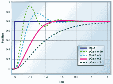

Figure 8 shows what happens when you add proportional feedback to the motor and gear system. For small gains (kp = 1) the motor goes to the correct target, but it does so quite slowly. Increasing the gain (kp = 2) speeds up the response to a point. Beyond that point (kp = 5, kp = 10) the motor starts out faster, but it overshoots the target. In the end the system doesn't settle out any quicker than it would have with lower gain, but there is more overshoot. If we kept increasing the gain we would eventually reach a point where the system just oscillated around the target and never settled out-the system would be unstable.
Figure 8: Motor and gear with proportional feedback position vs. time
The motor and gear start to overshoot with high gains because of the delay in the motor response. If you look back at Figure 2, you can see that the motor position doesn't start ramping up immediately. This delay, plus high feedback gain, is what causes the overshoot seen in Figure 8. Figure 9 shows the response of the precision actuator with proportional feedback only. Proportional control alone obviously doesn't help this system. There is so much delay in the plant that no matter how low the gain is, the system will oscillate. As the gain is increased, the frequency of the output will increase but the system just won't settle.

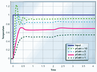

Figure 10 shows what happens when you use pure proportional feedback with the temperature controller. I'm showing the system response with a disturbance due to a change in ambient temperature at t = 2s. Even without the disturbance you can see that proportional control doesn't get the temperature to the desired setting. Increasing the gain helps, but even with kp = 10 the output is still below target, and you are starting to see a strong overshoot that continues to travel back and forth (this is called ringing).
Figure 10: Temperature controller with proportional feedback. The kink at time = 2 is from the external disturbance
As the previous examples show, a proportional controller alone can be useful for some things, but it doesn't always help. Plants that have too much delay, like the precision actuator, can't be stabilized with proportional control. Some plants, like the temperature controller, cannot be brought to the desired set point. Plants like the motor and gear combination may work, but they may need to be driven faster than is possible with proportional control alone. To solve these control problems you need to add integral or differential control or both.

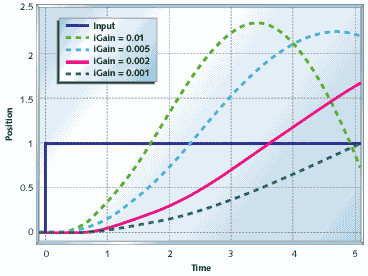

Figure 11: Motor and gear with pure integral control
Integral control by itself usually decreases stability, or destroys it altogether. Figure 11 shows the motor and gear with pure integral control (pGain = 0). The system doesn't settle. Like the precision actuator with proportional control, the motor and gear system with integral control alone will oscillate with bigger and bigger swings until something hits a limit. (Hopefully the limit isn't breakable.)

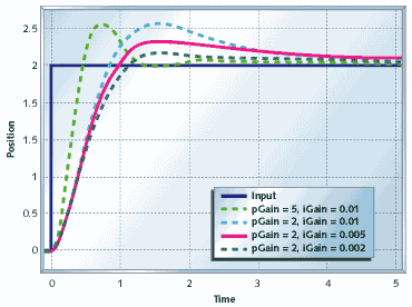

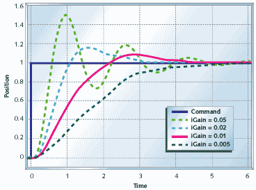

Figure 13: Motor and gear with PI control
Figure 13 shows the motor and gear with proportional and integral (PI) control. Compare this with Figures 8 and 11. The position takes longer to settle out than the system with pure proportional control, but it will not settle to the wrong spot.

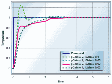

Figure 14: Heater with PI control. The kink at time = 2 is from the external disturbance
Figure 14 shows what happens when you use PI control on the heater system. The heater still settles out to the exact target temperature, as with pure integral control (see Figure 12), but with PI control, it settles out two to three times faster. This figure shows operation pretty close to the limit of the speed attainable using PI control with this plant.

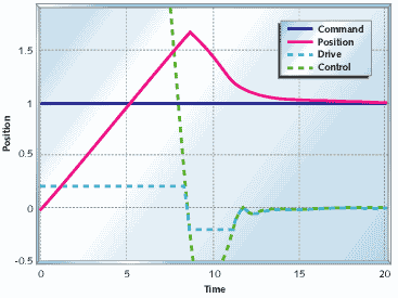

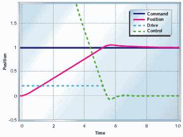

If you have a controller that needs to push the plant hard, your controller output will spend significant amounts of time outside the bounds of what your drive can actually accept. This condition is called saturation. If you use a PI controller, then all the time spent in saturation can cause the integrator state to grow (wind up) to very large values. When the plant reaches the target, the integrator value is still very large, so the plant drives beyond the target while the integrator unwinds and the process reverses. This situation can get so bad that the system never settles out, but just slowly oscillates around the target position.
Figure 15: Motor and gear with PI control and windup
Figure 15 illustrates the effect of integrator windup. I used the motor/controller of Figure 13, and limited the motor drive to 0.2. Not only is controller output much greater than the drive available to the motor, but the motor shows severe overshoot. The motor actually reaches its target at around five seconds, but it doesn't reverse direction until eight seconds, and doesn't settle out until 15 seconds have gone by.
Figure 16: Motor and gear with PI control and integrator limiting
The easiest and most direct way to deal with integrator windup is to limit the integrator state, as I showed in my previous code example. Figure 16 shows what happens when you take the system in Figure 15 and limit the integrator term to the available drive output. The controller output is still large (because of the proportional term), but the integrator doesn't wind up very far and the system starts settling out at five seconds, and finishes at around six seconds.

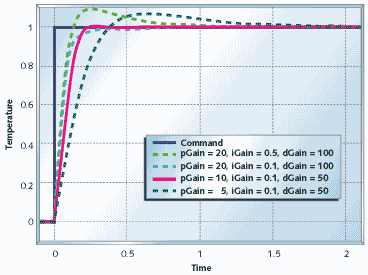

Differential

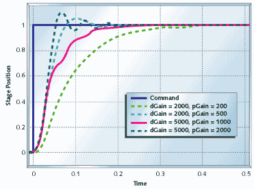

I didn't even show the precision actuator in the previous section. This is because the precision actuator cannot be stabilized with PI control. In general, if you can't stabilize a plant with proportional control, you can't stabilize it with PI control. We know that proportional control deals with the present behavior of the plant, and that integral control deals with the past behavior of the plant. If we had some element that predicts the plant behavior then this might be used to stabilize the plant. A differentiator will do the trick.
The code below shows the differential term of a PID controller. I prefer to use the actual plant position rather than the error because this makes for smoother transitions when the command value changes. The differential term itself is the last value of the position minus the current value of the position. This gives you a rough estimate of the velocity (delta position/sample time), which predicts where the position will be in a while.
double dTerm;
dTerm = pid->dGain * (position - pid->dState);
pid->dState = position;
Figure 17: Precision actuator with PID control
With differential control you can stabilize the precision actuator system. Figure 17 shows the response of the precision actuator system with proportional and derivative (PD) control. This system settles in less than 1/2 of a second, compared to multiple seconds for the other systems. Figure 18 shows the heating system with PID control. You can see the performance improvement to be had by using full PID control with this plant.
Figure 18: Heater with PID control
Differential control is very powerful, but it is also the most problematic of the control types presented here. The three problems that you are most likely going to experience are sampling irregularities, noise, and high frequency oscillations. When I presented the code for a differential element I mentioned that the output is proportional to the position change divided by the sample time. If the position is changing at a constant rate but your sample time varies from sample to sample, you will get noise on your differential term. Since the differential gain is usually high, this noise will be amplified a great deal.
When you use differential control you need to pay close attention to even sampling. I'd say that you want the sampling interval to be consistent to within 1% of the total at all times-the closer the better. If you can't set the hardware up to enforce the sampling interval, design your software to sample with very high priority. You don't have to actually execute the controller with such rigid precision-just make sure the actual ADC conversion happens at the right time. It may be best to put all your sampling in an ISR or very high-priority task, then execute the control code in a more relaxed manner.
Differential control suffers from noise problems because noise is usually spread relatively evenly across the frequency spectrum. Control commands and plant outputs, however, usually have most of their content at lower frequencies. Proportional control passes noise through unmolested. Integral control averages its input signal, which tends to kill noise. Differential control enhances high frequency signals, so it enhances noise. Look at the differential gains that I've set on the plants above, and think of what will happen if you have noise that makes each sample a little bit different. Multiply that little bit by a differential gain of 2,000 and think of what it means.
You can low-pass filter your differential output to reduce the noise, but this can severely affect its usefulness. The theory behind how to do this and how to determine if it will work is beyond the scope of this article. Probably the best that you can do about this problem is to look at how likely you are to see any noise, how much it will cost to get quiet inputs, and how badly you need the high performance that you get from differential control. Once you've worked this out, you can avoid differential control altogether, talk your hardware folks into getting you a lower noise input, or look for a control systems expert.

Tuning
The nice thing about tuning a PID controller is that you don't need to have a good understanding of formal control theory to do a fairly good job of it. About 90% of the closed-loop controller applications in the world do very well indeed with a controller that is only tuned fairly well.
If you can, hook your system up to some test equipment, or write in some debug code to allow you to look at the appropriate variables. If your system is slow enough you can spit the appropriate variables out on a serial port and graph them with a spreadsheet. You want to be able to look at the drive output and the plant output. In addition, you want to be able to apply some sort of a square-wave signal to the command input of your system. It is fairly easy to write some test code that will generate a suitable test command. Once you get the setup ready, set all gains to zero. If you suspect that you will not need differential control (like the motor and gear example or the thermal system) then skip down to the section that discusses tuning the proportional gain. Otherwise start by adjusting your differential gain.
The way the controller is coded you cannot use differential control alone. Set your proportional gain to some small value (one or less). Check to see how the system works. If it oscillates with proportional gain you should be able to cure it with differential gain. Start with about 100 times more differential gain than proportional gain. Watch your drive signal. Now start increasing the differential gain until you see oscillation, excessive noise, or excessive (more than 50%) overshoot on the drive or plant output. Note that the oscillation from too much differential gain is much faster than the oscillation from not enough. I like to push the gain up until the system is on the verge of oscillation then back the gain off by a factor of two or four. Make sure the drive signal still looks good. At this point your system will probably be responding very sluggishly, so it's time to tune the proportional and integral gains.
If it isn't set already, set the proportional gain to a starting value between 1 and 100. Your system will probably either show terribly slow performance or it will oscillate. If you see oscillation, drop the proportional gain by factors of eight or 10 until the oscillation stops. If you don't see oscillation, increase the proportional gain by factors of eight or 10 until you start seeing oscillation or excessive overshoot. As with the differential controller, I usually tune right up to the point of too much overshoot then reduce the gain by a factor of two or four. Once you are close, fine tune the proportional gain by factors of two until you like what you see.
Once you have your proportional gain set, start increasing integral gain. Your starting values will probably be from 0.0001 to 0.01. Here again, you want to find the range of integral gain that gives you reasonably fast performance without too much overshoot and without being too close to oscillation.
